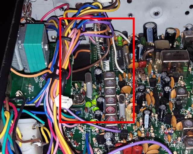

Hello James
There seem to be two models of PCB
James please should display the images of your PCB
Claude

Okay Claude and Sue, Here is the inside of mine ! Tried to do this with my phone first but said the files were too BIG lmao.
Here ya go so let's start here, Retro

Hello James
Only possible if this connector exists but not visible in your PCB

Post by lbcomms » 15 Jan 2019, 11:26
Don't worry about the connectors, the wiring to those can change during the production life and getting changes wrong can create expensive smoke.
First up, you'll need a soldering iron, a short length of thin wire (30cm will be plenty), and a basic multimeter that can measure up to 12 volts.
If you can do that, take a detailed picture of the area outlined in red below:
Move any wires out the way to get a good shot of the main circuit board.
The big IC (at the top-right of the above area) needs to have its part number visible.
Also include any numbers written on the crystal (the grey component centre of above red enclosed area) next to the trimpot.
Last, is the clarifier a single or dual control, and what color wires (usually there are three) go to that control.
Once we have that info, I'll get you to:
- take one voltage measurement
- remove one component
- remove one wire
- add one wire
I'll explain those 4 steps in detail once you have replied with the picture, the numbers on the component, and the wire colors.
You should then have an unlocked radio by the end of the week...
