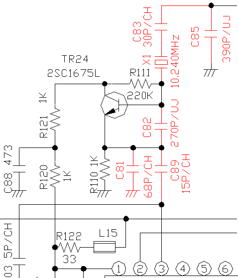

The 10.240 MHz oscillator. Generates the 10KHz channel steps, so if its too high the higher channels will be too high and the lower channels too low. The reverse applies if it's too low. In the donor radio it was low but varied only marginally with temperature.
The components in red affect the frequency. By reducing the 30pF capacitor to 27pF we could set it spot on, measured at the 5.12Mhz output pin of the PLL so we wouldn't load down the oscillator. It varied by only a few Hz between cold and hot, so we left this part of the circuit as-is for now at least.
The 10.240 MHz oscillator circuit

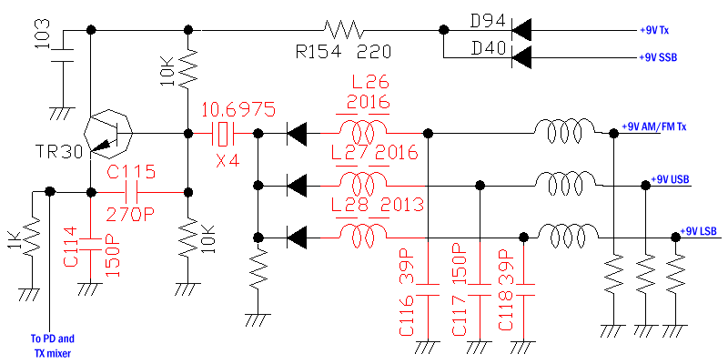

Next is the carrier insertion oscillator (CIO). This needs to operate on two or three different frequencies (the 3900 we had uses three) depending on the operating mode. For AM transmission, it operates at 10.695 MHz, which passes through the crystal filter and mixes with the 16 MHz local oscillator to produce the 27MHz transmit signal which is then high level modulated. It must be disabled for AM reception, otherwise it would swamp any incoming signals passing through the first IF stage.
For SSB, it has to be at the edge of the IF filter passband in both Rx and Tx to pass one sideband and reject the other. By putting the signal at the low or high end of the passband, the desired sideband can be selected. For our 3900, the oscillator needs to run at 10.6925 MHz for upper sideband operation and 10.6975 MHz for lower. 3 tunable inductors and capacitors connected from one side of each inductor to ground are used to set the frequency. Those components, plus the crystal and the two phase shifting capacitors in the oscillator are all temperature sensitive (the components shown in red below).
How much by? By using a hot air pencil set to minimum and a can of Freon spray we were able to shift the RF frequency by just over 1KHz by heating and cooling those parts.
The 10.695 MHz oscillator circuit
